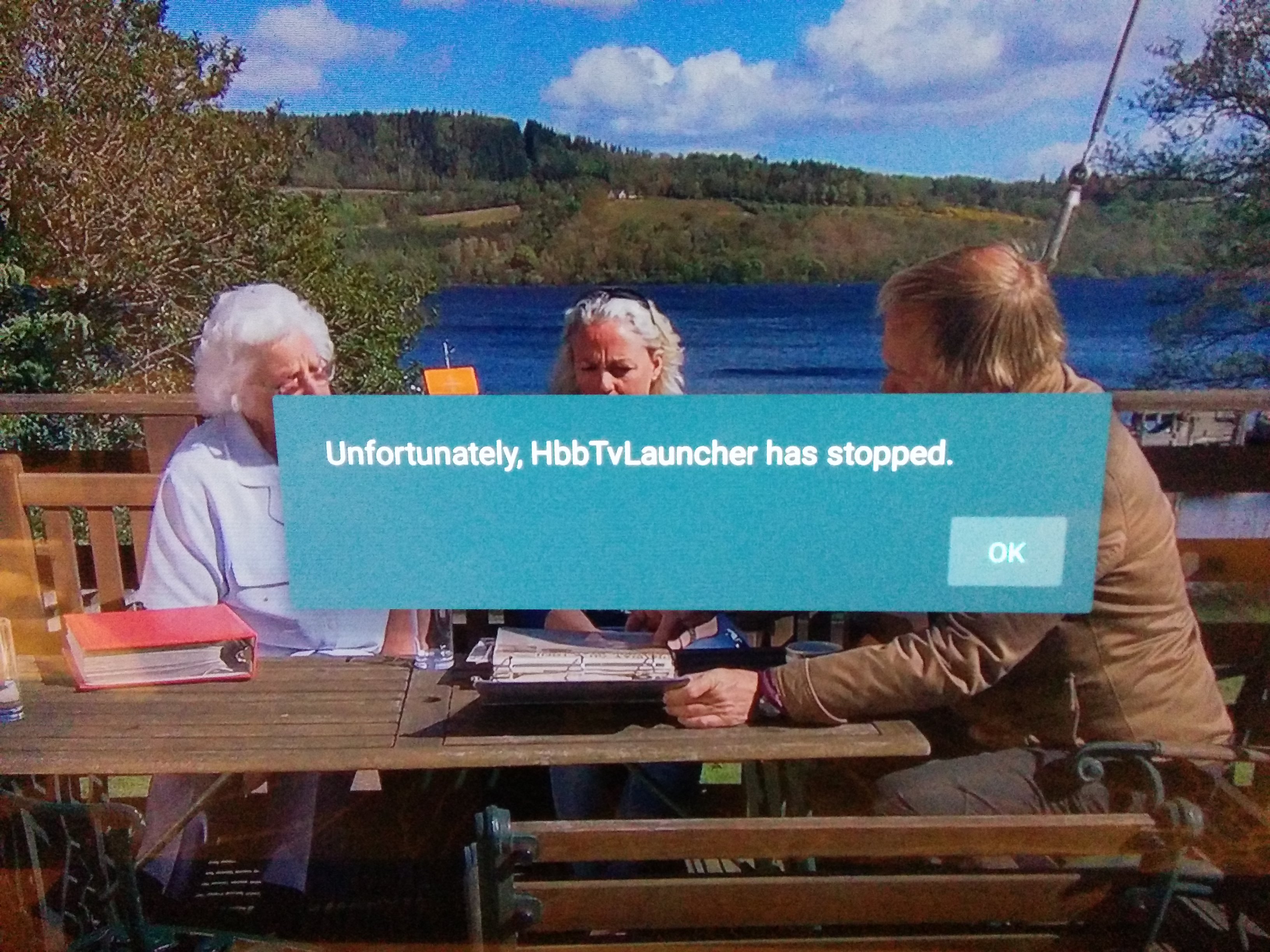

I've had my first error after updating to the latest firmware... That
didn't take long 😞
rdlowry
didn't take long 😞
Forgot to include image... This happened when switching to Freeview

Ah @rdlowry that HbbTVLauncher error is not new, I've been having that one for a while.
Have done update, not tried a lot but seems a bit snappier, and the input labels are now shown alongside the input number when you switch inputs. The guide uses the new freeview logo, no idea if that was there before as I don't use the inbuilt tuner. I did notice some slight lip sync error on the internal tuner, though curiously it seems to be in the other direction (i.e. the sound is slightly ahead). Time will tell if HDMI lip sync is fixed. Plex is still 2 channel, whether you enable passthrough in plex or not.
