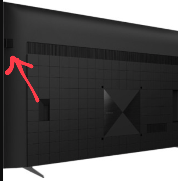

Just to elaborate on the problem.
What I have noticed in the meantime, the static noise is coming out of the side slots on the TV (see picture).
And the static noise is always there when you turn on the TV. It's on the steady level (doesn't get louder with turning the volume up) no matter what sound option or streaming app you choose. One thing that I did notice, when you plug in the S-Center cable into the TV, the noise gets a little bit louder but then stays like that again, doesn't get louder with turning the volume up.
But honestly, I didn't notice that the static noise interfere with the sound quality when watching the TV, and with the fact that my guarantee period is over, Sony didn't set the new guarantee period after changing the whole motherboard. That was also a thing. After changing the motherboard, and the technician convincing me that everything is in perfect order, soon afther that, my other devices and Alexa did recognize the TV as completely different model (XR-65X90J i belive)... But well...
