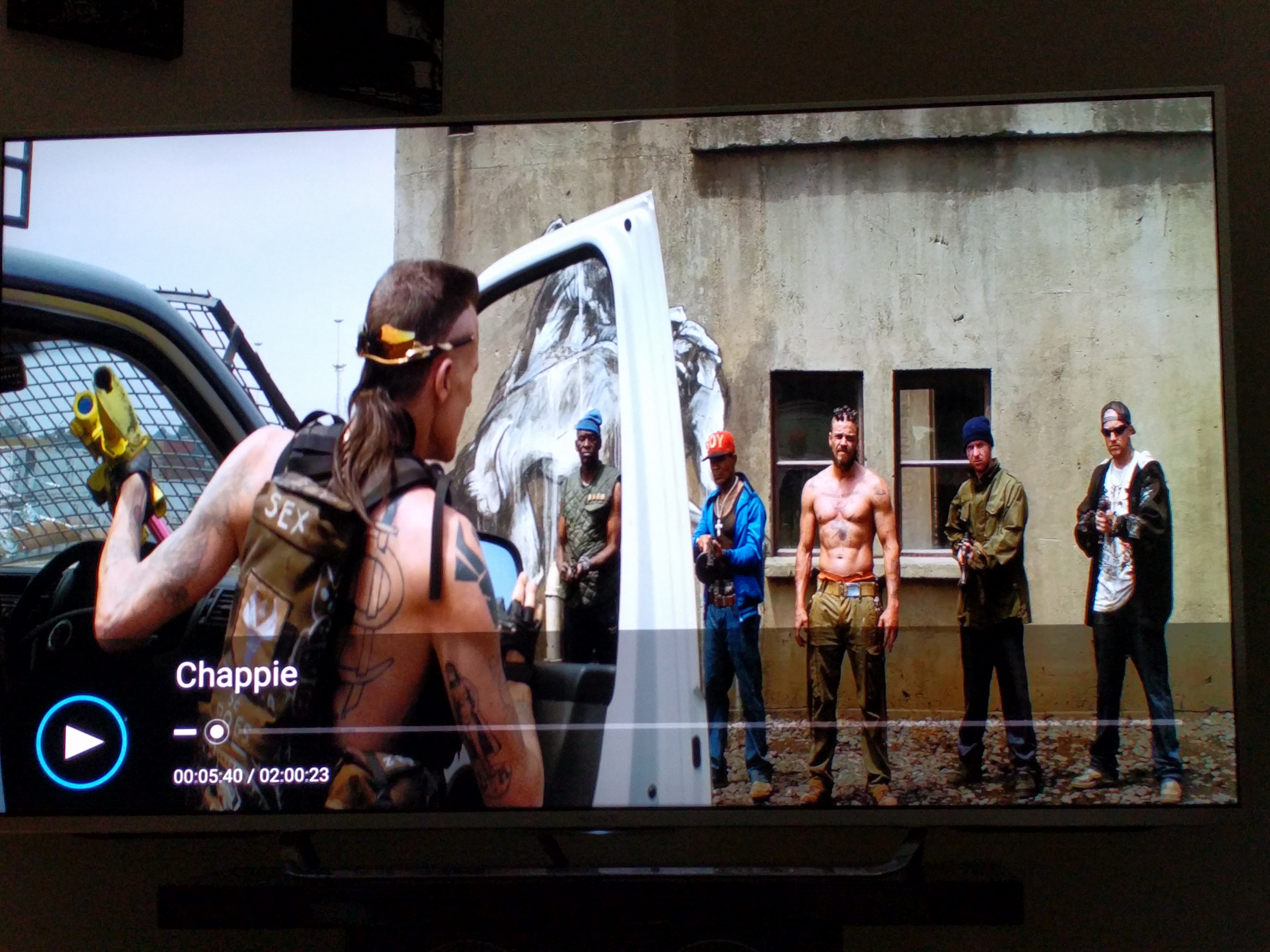

IMG_20160328_110459.jpgIMG_20160328_110459.jpgUnfortunately nothing. It's been escalated, and escalated. I've worked out the working version of Android Video App is : V:1.0.A.4.4 and the current faulty stretched aspect ratio is : V 1.0.A.5.16. Sony,please restore this working version in a simple firmware update,issue solved. And just to prove its absolutely nothing to to do with my media set up,I have attached 2 identical paused images from the film "Chappie"®™. The correct formatted 16:9 version is using Plex app from playstore, and the stretched using the Video app, I really do hope Sony start to listen,and give us the working update in a simple app OTA update. UPDATE: I was contacted today 12/⁴/16 by Sony support team, they informed me that there is a new update which may or may not fix my issue,if it did not fix it, the development team are aware and working hard on a fix. I installed the new update, it took around half an hour,so a failrly hefty one, i'm not sure what is was for or did as there's no visible change to TV menu,image etc? but it certainly hasn't fixed our Video app issues,still stretched I'm afraid to say. No information is available on support website in regards to the latest update,if anyone knows what it was for,please drop me a line/post. I really Cant believe technical department couldnt drop in the old video app in this recent firmware update, taking over 4 months now! Ive even supplied you with the working app version,a simple fix. Thank's for post Leebo, Unfortunately the menu is greyed out after pressing action menu on my KD55X8507/9 sets, so unfortunately, that wont fix it, tried already the first time,it only started after a November update.Fact.
