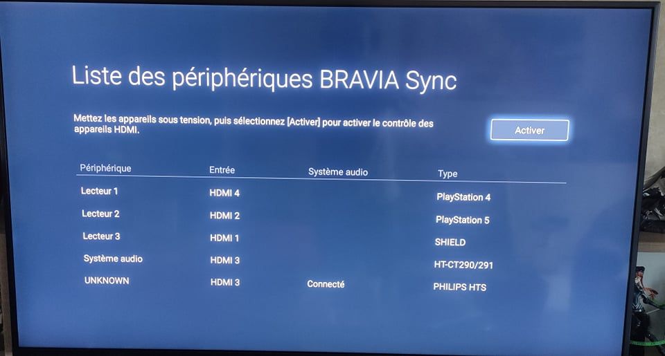

For some reason, when it doesn’t work, it seems to think the sound bar is a tv. See picture.

I have a TV Sony KD49XH8505BAEP since three weeks and a Sound Bar HT-CT290. Everything worked fine until today. I got no sound from the sound bar so I tried to reset it, reset the TV... nothing worked. I checked the Bravia Sync devices list and here is what I got :
As you can see on the photo, all my devices are identified even the HT-CT290 but now there is an "UNKNOWN" device connected PHILIPS HTS (which I never connected to my TV, I didn't even own this device). It takes control over the right sound bar and I can't delete it ! I try to clear the Bravia Sync Devices list but as soon as I plug my sound bar into the HDMI (arc or others ports have the same result) this annoying Unknown device come back.

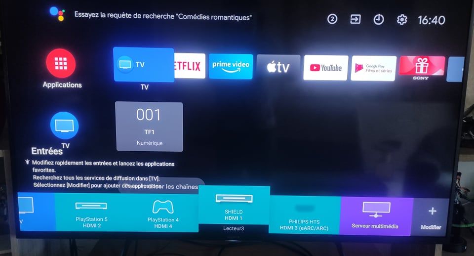

One more thing when I try to change my TV sources (on photo below) the "PHILIPS HTS" appears with a "shadow" HDMI icon and when I try to select it the sources menu disapears and nothing happen.

[Edit] : I tried to unplug everything one by one and don't ask me why but when I unplugged my PS4 everything went right again, I plug it again and it works. The unknow device disapeared. I don't understand what happened, sorry to bother you.
