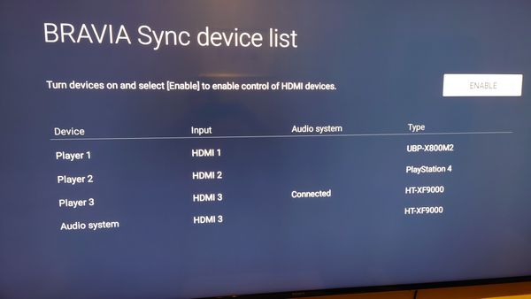

Having same problem on x90j Bravia sync works with soundbar Blu-ray player and PS4 but not picking up a PS5...? I have tried resetting TV unplugging PlayStation waiting going back in turning sync on and off on both devices still nothing....??? Picture showing TV finding everything but HDMI 4 for PS5.
  It use to work then nothing can't find..
