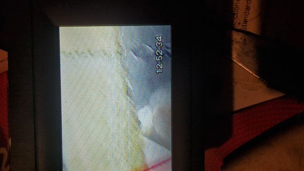

But whilst I'm asking for assistance can anyone tell me what is causing these lines:
These interference lines are what caused me to want to clean the camera heads. This is the second tape that they appear on. Which is why I thought that its the camera at fault rather than the tape itself.
The lines don't appear all the time, but when they do, they all look the same, a group of rainbkw-like-stripes that go across the screen, and slowly scroll up (occasionally they've appeared and scrolled down). Sometimes they've appeared in the middle before moving, other times they've appeared at the top/bottom and scrolled accordingly. And sometimes they disappear before they reach the other side, just popping in and out to say hello before they scroll back down below... 😪.
I'm not clued up enough on the effects of time & aging on old analog products, but for the most part the tapes & camera have been stored in a cool dry place. The tapes where stored with the camera inside the cushioned carry bag it came with, within the accessories compartment.
There was a period of time that it was stored in my parents loft. Which is very dusty and cold! But they were triple-bagged for protection. My dad was very particular about protecting our old things when we moved out (I'm one of four siblings).
So I doubt it's been dust; I'm stumped now — is it the camera, or the tape(s) ‐ I do have a third I've not played yet.
The tapes are exactly the same age, as I bought them all within ghe first 12 months of buying the camera, 2002/3, so the fact that the lines appear on more than one tape doesn't make it the camera's fault as I initially assumed.
So is this just an example of aging on a hi8 tape? Or is there a specific cause?
