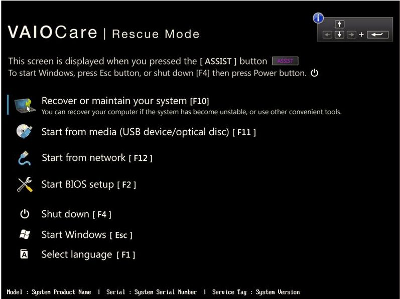

Hi Soli21014,
To access the BIOS with Windows 8/8.1 on a Vaio, press the assist button when fully shut down. You will then be presented with the following screen – press F2 to enter BIOS setup.
Rich
