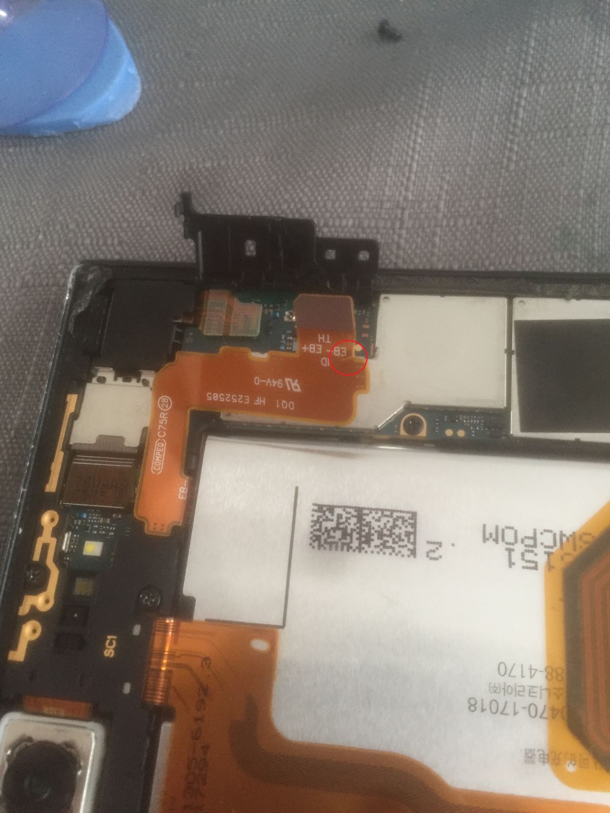

Just looking for a bit of advice on battery/charging issues with an XZ Premium. I just want a second opinion on whether the issues below are battery related or due to a wider issue to decide whether or not to repair.
This morning I had a camera error - "error: unknown error" when trying to use my camera. The flashlight also wouldn't work.
I then discovered a series of other issues relating to the battery/charging of the phone and I'm trying to establish whether these issues are all related or whether a replacement battery is required. With relation to battery:
Query is, would a slight tear in this cable result in the phone not charging but working via the mains, or, are these issues suggesting something more.
It's really a question of do I try a replacement battery or replacement phone!!!
Thanks in advance.

Stripped phone down, installed new battery and battery/charging issues have gone. Believe the tear in the battery flex cable was the fault and reason why the phone wouldn't hold a charge but fixed and all resolved.
