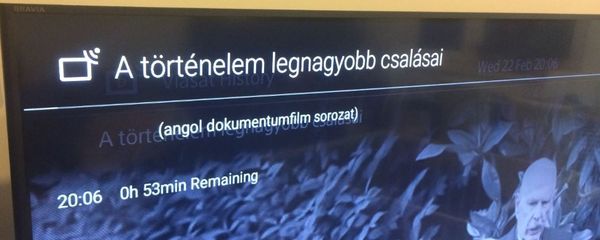

Double Overlay of top Info Banners
Problem:
In the favorite channel list, after changing channels, the tv shows double Info Banners. It happens on dvb-t. Only by favorite channels. Both analog and digital.
1. It is happening with all the channels in my favourite list.
2. There is no difference between HD and SD
3. DVB/T/2
It looks like there is the normal info banner and a new one, a favourite info banner. If I'm in the favourite list, the new banner is on top. If I press the info button it shows single, old type of extended banner.
Outside the favourite list there is only the old banner.
Reported by:
djmickey83 : HERE and HERE
rooobb
Updates:
25-02-2017 - Issue has been reported to Sony, any updates recieved will be communicated back.
