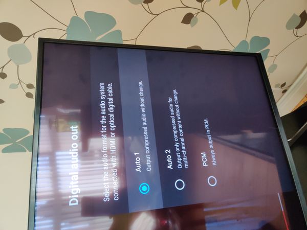

Thanks. I investigated this last night after seeing your initial response @royabrown2. Unfortunately my model doesn't have this as an option. This is what comes up ...

Oh dear, Sony seem to have gone backwards on the flexibility of Optical Out in recent TVs.
Perhaps a Sony person here can comment on this, and whether there is any control of the Optical Out volume level elsewhere on this TV?
