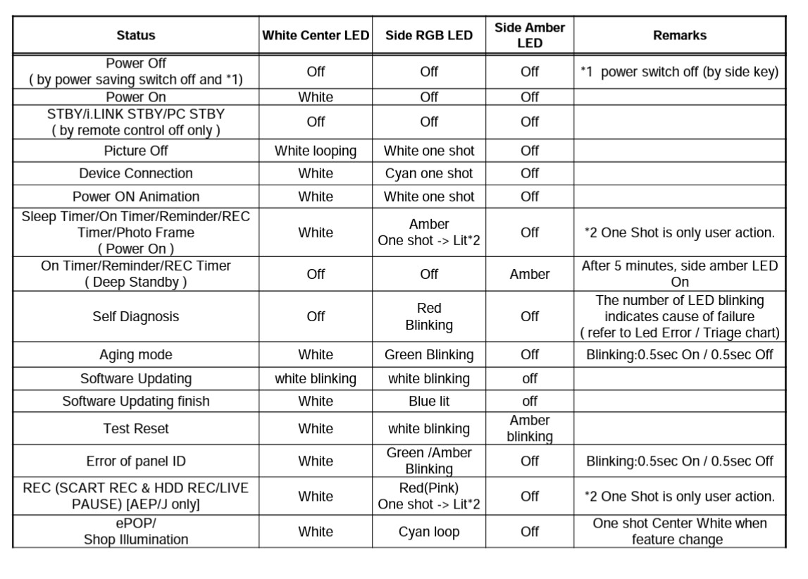

The following table is what the LED lights indicate:
And use the instructions @MiCal1967 posted too.
