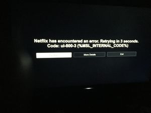

image.jpegThis is the message I'm getting all the time now
i have checked all connections and all are fine. I bought this television for the smart side of things
and so far this is just a joke
can anyone help
thanks

Hi @Ddrk49
This is unfortunately a known issue on Android TVs and BT HomeHubs (5).  Have a look at the links in the following post and see if it helps
https://community.sony.co.uk/t5/televisions/2015-android-tv-bugs-and-issues/m-p/2173823#M43946
