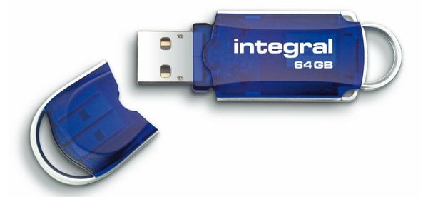

Tomas_90 wrote:
Recording straight to a USB flash drive would be preferred but apparently that doesn't work either?
Officially not supported.  But i had this one working on the KDL-43W805C:
Tomas_90
I tried using a 32 GB Sandisc USB but I could only play pictures or video from it.
