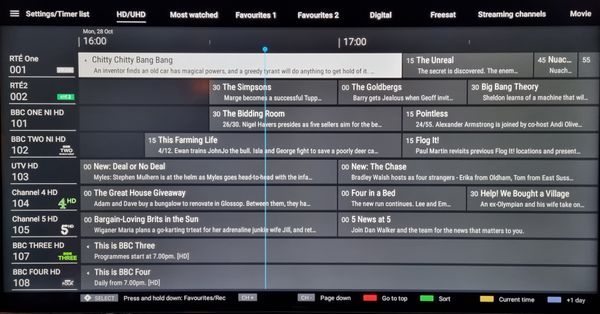

Hey @Deezell could you upload us a pic of how the EPG looks like now?
profile.country.IE.title
Deezell
Today's EPG on HD Genre. First 2 channels are local terrestrial.

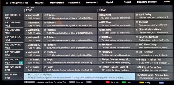

Next Monday 4th Nov EPG
Deezell
An oddity I've noticed is whichever regional BBC1 you've selected by dint of your postcode entry during scan, it's prime listing at 101  struggles to populate past 2 days, but scroll down to it's alternate listing in the 950s-969s and it has a full 7 day to Midnight Mon 4th, 8 days really. E.g. BBC ONE NI HD on 101 and 966, they're the same channel and tuning frequency, but when 966 is allocated the first Freesat slot at 101, it's EPG is slow to populate fully.
BBC regional Mon 4th Nov. This is 'No Programme Information' after 2 days in 101.
