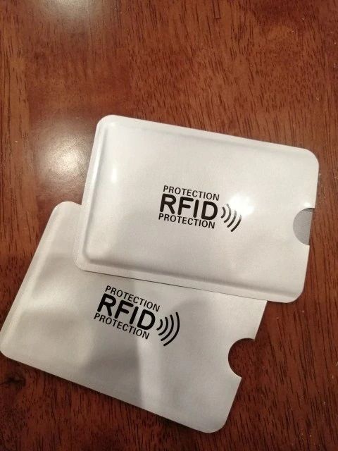

My NFC suddenly stopped working after I tried to scan my bank card inside RFID protection sleeve.

almir.sahbaz
@tomatojam
I tried a lot of different NFC devices, but my Xperia Z5 won't react to any of them.
It stopped working after I tried to read my bank card inside this RFID protection sleeve:
Now I don't know how to fix it.
