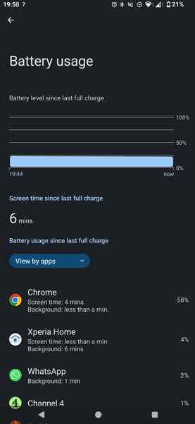

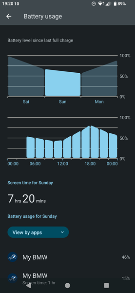

Hi I've just got an Xperia 1 vi but I've noticed the battery usage monitor is not working is this due to the android 15 update? I updated all the patches before I set the phone up to use.

I seem to have found a solution after trawling the internet for a fix.
From an old post for a Samsung phone with similar issues on XDA, it was suggested to change the date manually to an older date then back to automatic.
Definitely a bug.

I found another user who was experiencing the same issue he suggested deleting the app data and cache for the settings apk.
This has helped somewhat but it is still showing strange recording behaviour.

I performed a factory reset last Thursday.
I did a full clean (not using Google backup incase that was causing issues)
It is still not working correctly it is showing gaps in usage.
