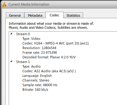

The original MP4 file was 827 MB
New AC3 encoded file is 1.24 GB
Here's the VLC Codec Info - It looks right to me and sounds good on my PC
I will test on the DN1040 later
Cheers again Quinnicus - Lucky Star Awarded! :clap:

Cool - sounds about right, AC3 will increase the filesize.
