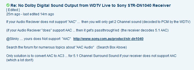

Just had some feedback from a friend on WD forum which has resolved the issue. Now I am not so happy!
Thankfully though I only have a few movies recorded in this format, mostly I watch DVD's instead which play lovely!
Thanks again Quinnicus for your advice, you're a star!

Ok, I think it 'might' be best to try it twice :slight_smile: as a test run and see which one works best - before converting the rest.  Then you see which one 'works' best (hopefully)
Test 1
Source = 1 English (aac) (2.0 ch)
Codec = AC3 (ffmpeg)
Mixdown = None
Leave rest as defaults
Test 2
Mixdown = Dolby Pro Logic II
Don't use AC3 Passthru for this.

Thanks for posting back the answer, which is Interesting itself.

Do you think I can achieve what Joey is saying above using 'Handbrake', if so will it effect picture quality if I re-encode it??

Honestly, I dont know, sounds about right though.  Nothing hurts to try.
I still cannot see anything in the specs to indicate that AAC is not supported (even on the aussie Sony website.)
However, if others have tried and thats the solution, who am i to argue that!  Do other vids play ok, with pass-through?  Have you tested others?

The passthru in handbrake, is not for receivers :slight_smile:
"The next method is called pass-through. This just copies, bit-for-bit, the soundtrack on your DVD." - use it anyhow.
https://trac.handbrake.fr/wiki/SurroundSoundGuide
Firstly, your "source" audio is already 2ch.  Its only adding "processing" to make it 5.1 if thats what you require.  Personally, I dont "down mix", so set that to "None"
Secondly, you have two audio tracks showing?
EDIT: Upon saying that, you wanted Dolby, so use the Dolby Pro Logic II as a mixdown, just change codec to AC3.
